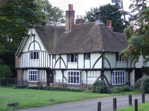

Yes Rick, my tree was probably one that was used for those Agincourt longbows, it would already have been five hundred years old at the time, and was in my garden, a manor farm garden in an area that supplied a large contingent of the longbowmen.
My house was originally built at around the time as oak from my building has been dated as having been cut in the early 15th century.

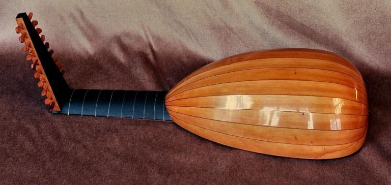

PostPosted: Mon Nov 19, 2007 5:21 am
Colin, your house looks in remarkably good shape considering the age. My locality is FULL of 15th Century black and white timber-framed houses jutting out at interesting angles- each floor bigger than the one below. Was it a school house at one time? (referring to the bell tower)
Beautiful lute, by the way!

PostPosted: Mon Nov 19, 2007 5:35 am
No not a school house at any time, the bell was rung to tell the farm labourers it was time to start work, etc. The jetteing of one floor out over the one below was to so that the weight of the wall of the overhanging storey canterlevered the weigth of the floor and the furniture inside.
By the way I think every succeeding century has left a mark on the house. But it would have been a very grand hall-house (albeit only one room) when originally built, but the main frame and the whattle and daub walls are all original. The latest change was in the 19th century when the old rotten sandstone loweer section was replaced with brick. It still has no foundations though!

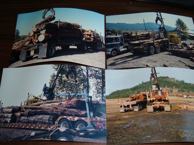

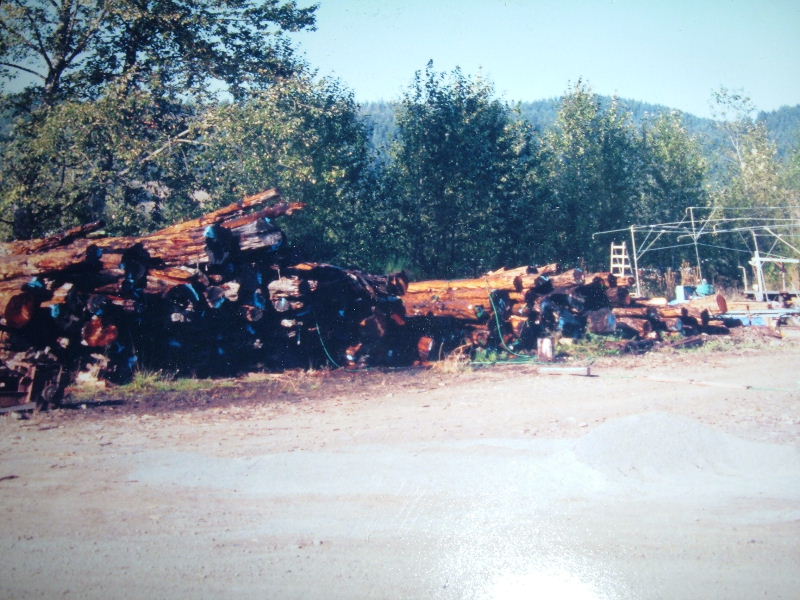

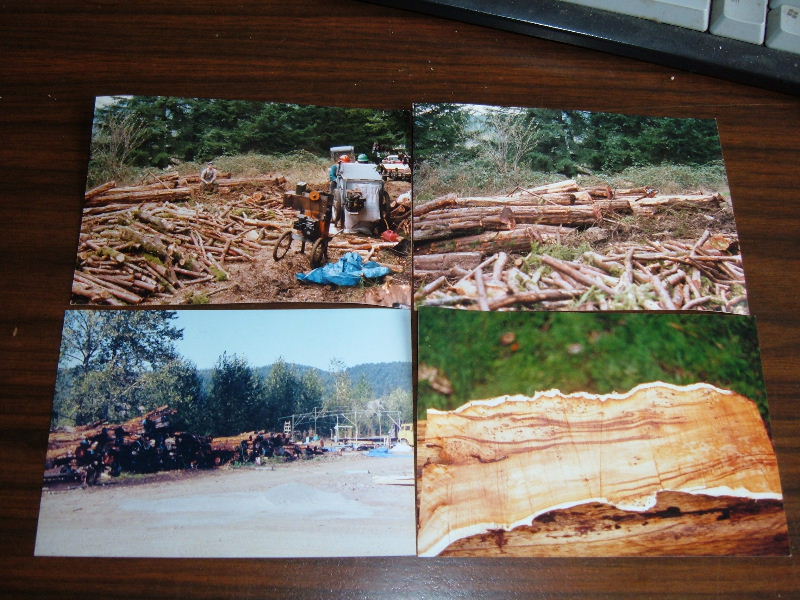

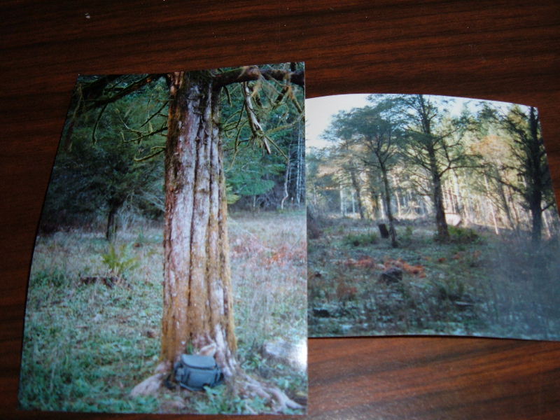

Sam, thanks for the thread and photo as it brings back many fond memories of harvesting our Pacific Yew in Oregon ( I know all the "yew" jokes). For several years I purchased standing Yew trees from private lands and as a pre-harvest before logging operations began. Yews are understory trees and do not survive well in the open sun after logging has removed the conifer canopies that protect them. This has been so long before we began harvesting the bark for extraction of Taxanes for Bristol-Meyers Squibb to produce their trademarked named drug, Taxol so in truth this harvesting did not "decimate" the Yew in these parts. The state of Oregon has a full and extensive inventory of Yews in the state and it's pretty extensive. I have no idea what goes on in Canada, however. An interesting point is there were two companies involved, B-M Squibb and a Colorado company named NAPRO. I sold to both, but B-M Squibb had enough bureaucratic clout to get the FDA to not approve NAPRO's method of taxane extraction from the bark. This put B-M Squibb as the only extractor in the world. Well, there actually was a small company from England that came over at the end of the bark harvest and bought up several thousand kilos of bark for processing. B-M Squibb had discontinued domestic harvesting and was closing in on partial synthesizing
I set up a sawmill to cut Yew lumber specifically and it was fun cutting thousands of board feet for the flooring industry. I shipped several high quality loads of Yew logs to veneer companies
"Pippy" refers to the tight knots formed when the tree forms bud growth. The only bending problem you might encounter is they sometimes simply fall out....not all tightly encased. You might consider super glue on the pips before bending if they appear suspicious.
Yew is not an oily wood and glues fine. It's density is a bit less than rock maple...pretty heavy for an evergreen softwood never the less.
Yews are female or male tress and require pollination to reproduce so we find them generally in Groves and rarely as single trees.
I don't believe the toxicity is any higher or lower than any other wood dust. It depends on one's chemical sensitivity. Ipe and walnut can produce blisters on me, but never a problem with Yew. All wood dust should be considered nasal carcinogenic. Perhaps the Yew's "tree of death" status in European mythology is taken a bit to far as it means the Yew is revered as part of the life-death cycle and not "death causing".
Here's some old photos of some Yews we harvested. Yew log deck and the frame of the sawmill cover my son and I built. Bark and log harvesting operation. We used flails to remove the winter bark. I ran several crews at different times. Several loads of veneer logs being readied for shipment. I once bought a yew log from the BLM for $1.00 and the veneer mill, sliced and sold the veneer for $12,000 of which I got half..told you fond memories Photo of some standing yews left after logging the conifers which I had purchased. Sorry for the long post..hope you find it interesting.
PostPosted: Tue Nov 20, 2007 6:00 am
Larry,
I enjoyed reading your post and thanks for the Pics. The first group of pics on the bottom right of the close up cross-section of Yew is the type of stripy figure that a dear woodworking friend loves- there's a stunning coffee table he has made in his living room that has outlived forty years of marriage and four kids.
